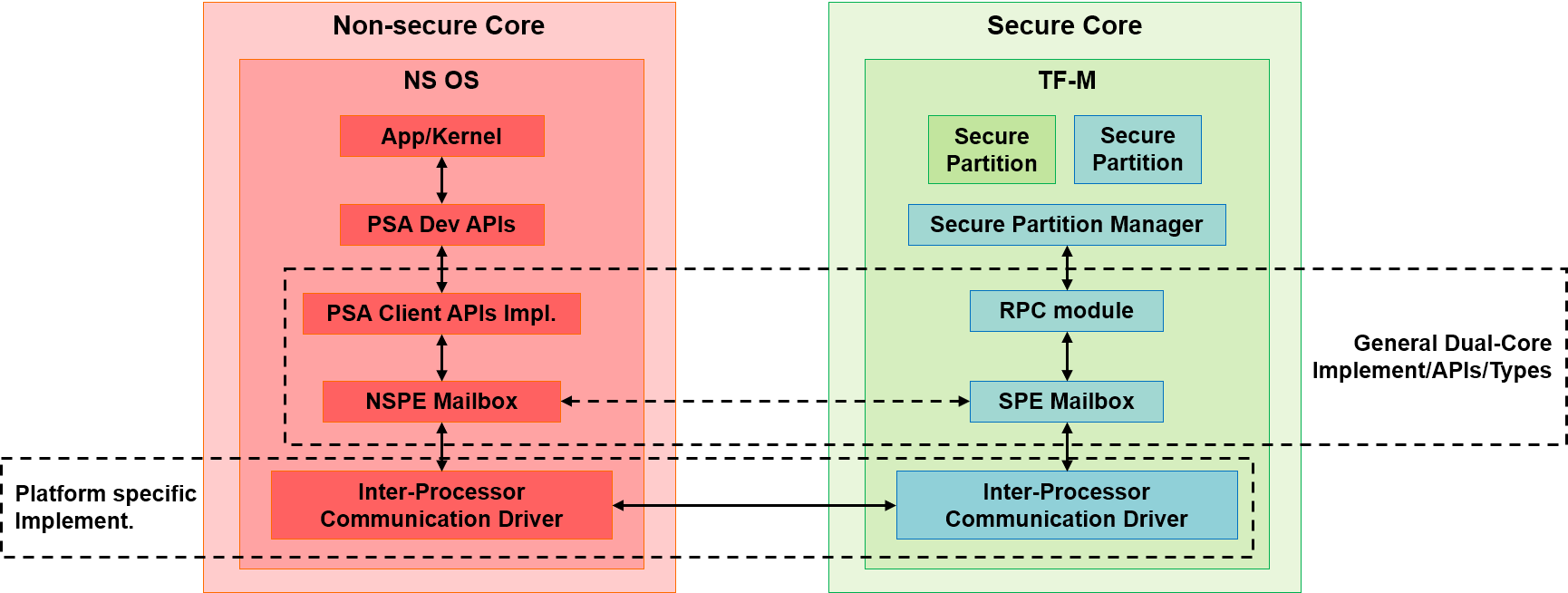

The mailbox consists of two parts sitting in NSPE and SPE respectively. NSPE mailbox provides mailbox functionalities in NSPE and SPE mailbox provides mailbox functionalities in TF-M in SPE.
PSA Client APIs called in NSPE are implemented by NSPE mailbox functions on dual-core systems, to send PSA Client request and receive the result. The implementation can vary in diverse NSPE OSs or use cases.
TF-M provides a reference implementation of NSPE mailbox. The NSPE mailbox delivers the PSA Client requests to SPE mailbox. After the PSA Client result is replied from SPE, NSPE mailbox fetches the result and returns it to PSA Client APIs.
NSPE mailbox objects are managed by NSPE mailbox in non-secure memory to hold PSA Client call parameters, return result and other mailbox data. NSPE mailbox relies on platform specific Inter-Process Communication to process notifications between NSPE and SPE.
The SPE mailbox in TF-M receives PSA Client requests from NSPE mailbox. It parses the requests and invokes TF-M Remote Procedure Call (RPC) layer. RPC layer delivers the requests to TF-M core/Secure Partition Manager (SPM). After the PSA Client call is completed, TF-M core/SPM invokes RPC layer to return results to NSPE, via SPE mailbox. SPE mailbox objects are managed by SPE mailbox in secure memory. SPE mailbox relies on platform specific Inter-Process Communication to process notifications between SPE and NSPE.
The architecture is showed in following figure.
