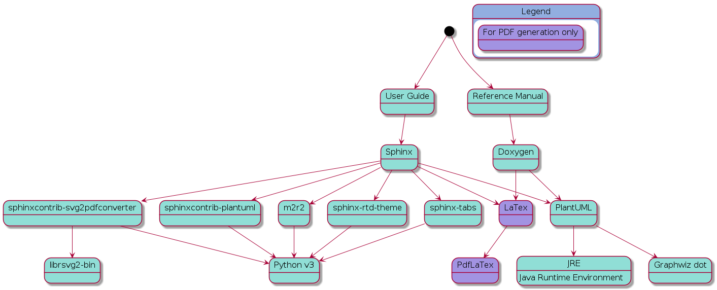

Dependencies
@startuml
 skinparam state {
   BackgroundColor #92AEE0
   FontColor black
   FontSize 16
   AttributeFontColor black
   AttributeFontSize 16
   BackgroundColor<<pdf>> #A293E2
   BackgroundColor<<doc>> #90DED6
 state u_guide as "User Guide" <<doc>>
 state refman as "Reference Manual" <<doc>>
 state rtd_theme as "sphinx-rtd-theme" <<doc>>
 state tabs as "sphinx-tabs" <<doc>>
 state sphnix_puml as "sphinxcontrib-plantuml" <<doc>>
 state sphnix_svg as "sphinxcontrib-svg2pdfconverter" <<doc>>
 state JRE as "JRE" <<doc>> : Java Runtime Environment
 state gwiz as "Graphwiz dot" <<doc>>
 state Sphinx as "Sphinx" <<doc>>
 state python as "Python v3" <<doc>>
 state m2r as "m2r2" <<doc>>
 state PlantUML as "PlantUML" <<doc>>
 state LaTex as "LaTex" <<pdf>>
 state PdfLaTex as "PdfLaTex" <<pdf>>
 state Doxygen as "Doxygen" <<doc>>
 state librsvg as "librsvg2-bin" <<doc>>
 [*] --> u_guide
 u_guide --> Sphinx
 Sphinx --> m2r
 Sphinx --> rtd_theme
 Sphinx --> tabs
 Sphinx --> sphnix_puml
 Sphinx --> sphnix_svg
 m2r --> python
 rtd_theme --> python
 tabs --> python
 sphnix_puml --> python
 sphnix_svg --> python
 sphnix_svg --> librsvg
 Sphinx --> PlantUML
 PlantUML --> JRE
 PlantUML --> gwiz
 Sphinx --> LaTex
 LaTex --> PdfLaTex
 [*] --> refman
 refman --> Doxygen
 Doxygen --> PlantUML
 Doxygen --> LaTex
 state Legend {
   state x as "For PDF generation only" <<pdf>>
@enduml
