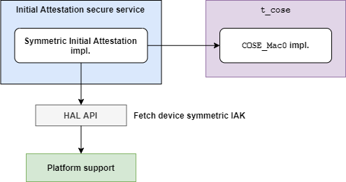

Design overview
The symmetric Initial Attestation follows the existing IAT generation sequence for Initial Attestation based on asymmetric key algorithm (asymmetric Initial Attestation for short).
As Profile Small design [2] requests, a configuration flag SYMMETRIC_INITIAL_ATTESTATION selects symmetric initial attestation during build.
The top-level design is shown in Overall design diagram below.
../../_images/overall_diagram.png
Figure 15: Overall design diagram
Symmetric Initial Attestation adds its own implementations of some steps in IAT generation in Initial Attestation secure service. More details are covered in IAT generation in Initial Attestation secure service.
The interfaces and procedures of Initial Attestation secure service are not affected. Refer to Initial Attestation Service Integration Guide [3] for details of the implementation of Initial Attestation secure service.
Symmetric Initial Attestation invokes t_cose library to build up COSE_Mac0 structure. COSE_Mac0 support was originally added to the t_cose library fork in TF-M, however since t_cose 2.0 it is part of the upstream library [4] which is already used by TF-M too.
Several HAL APIs are defined to fetch platform specific assets required by Symmetric Initial Attestation. For example, tfm_plat_get_symmetric_iak() fetches symmetric Initial Attestation Key (IAK). Those HAL APIs are summarized in HAL APIs.
Decoding and verification of symmetric Initial Attestation is also included in this proposal for regression test. The test suites and IAT decoding are discussed in TF-M Test suite.
QCBOR library and Crypto service are also invoked. But this proposal doesn’t require any modification to either QCBOR or Crypto service. Therefore, descriptions of QCBOR and Crypto service are skipped in this document.
