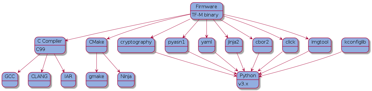

Tool & Dependency overview
To build the TF-M firmware the following tools are needed:
C compiler of supported toolchains
CMake version 3.21 or later
Git
gmake, aka GNU Make
Python >=v3.11
[Optionally] uv
