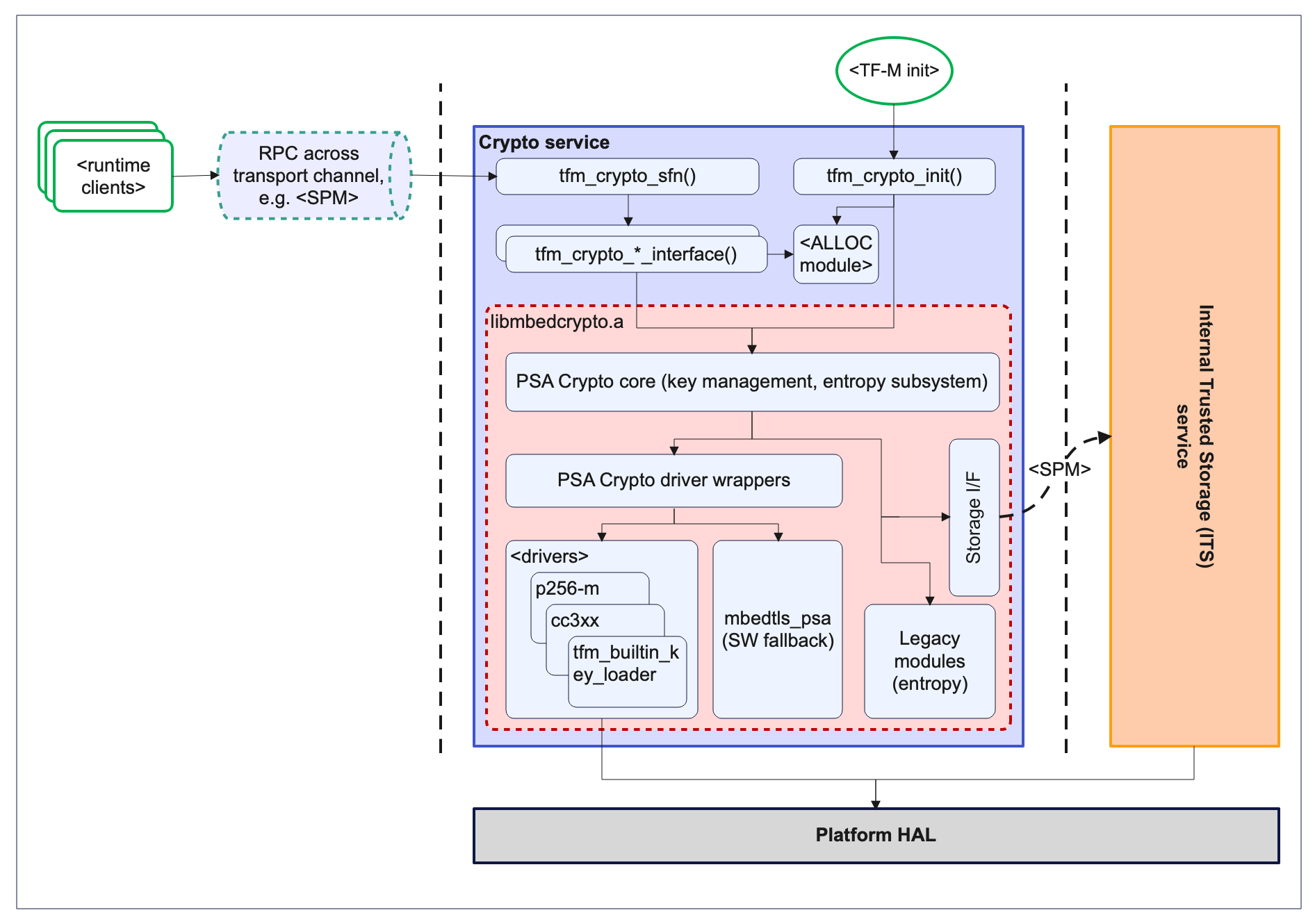

The interaction between the different components is described by the block diagram in Figure 14:
../../_images/psa_rot_crypto_service_architecture.png
Figure 14: Block diagram of the firmware architecture of the TF-M Crypto service. Dotted lines between services represent isolation boundaries once runtime firmware is initialized, i.e. TF-M init phase has completed. The diagram is simplified and shows only the major functional blocks, for a more detailed libtfpsacrypto.a architecture please refer to [3].
