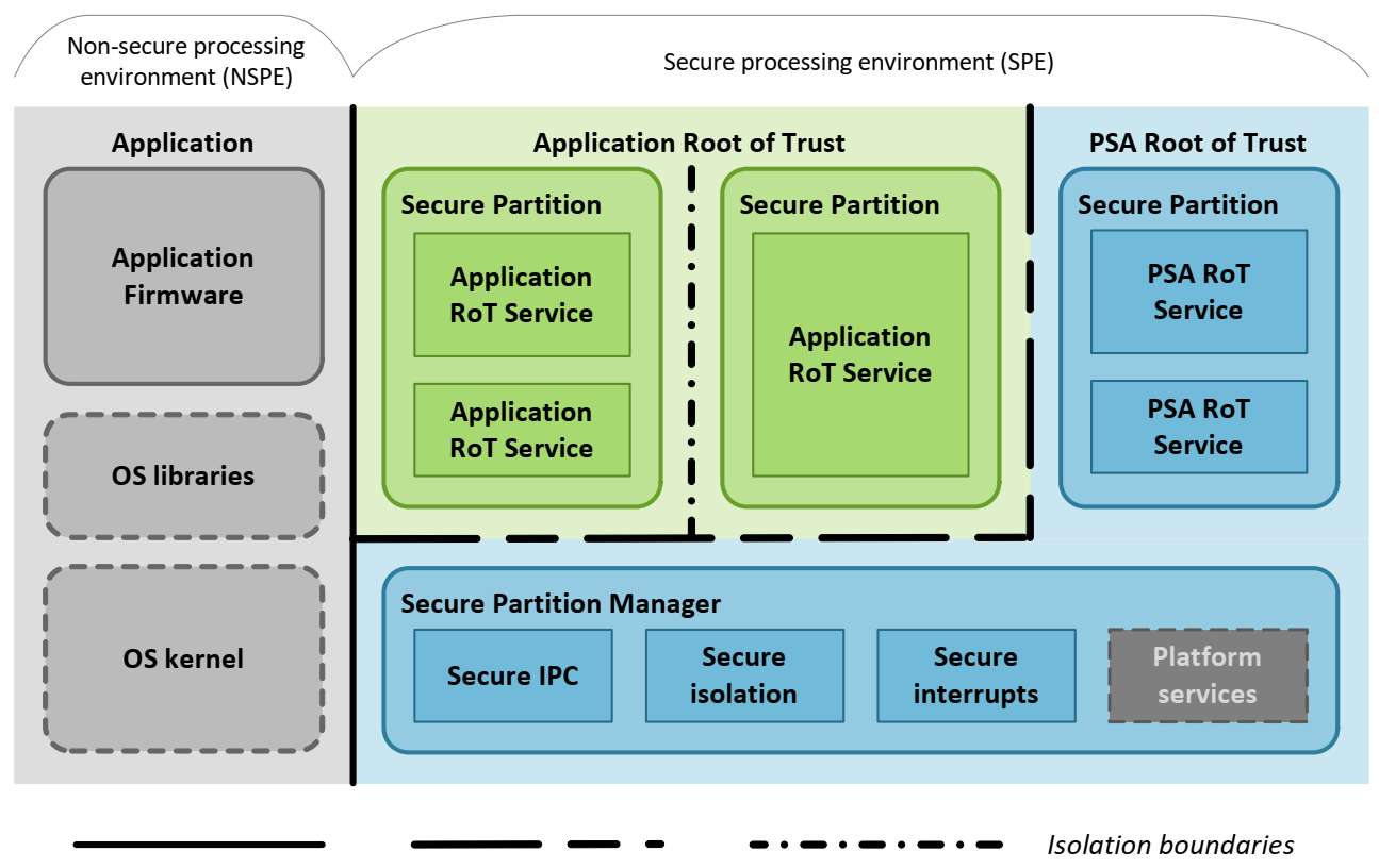

A typical TF-M system diagram from a high-level overview is shown below. TF-M is running in the Secure Processing Environment (SPE) and Non-Secure (NS) software is running in Non-Secure Processing Environment (NSPE). For more details, please refer to Platform Security Architecture Firmware Framework for M (FF-M) [FF-M] and FF-M 1.1 Extensions [FF-M-1.1-Extensions].
../../_images/TF-M-block-diagram.png
The TOE in this general model is the SPE, including TF-M and other components running in SPE.
The TOE can vary in different TF-M models, RoT services and usage scenarios. Refer to dedicated threat models for the specific TOE definitions.
